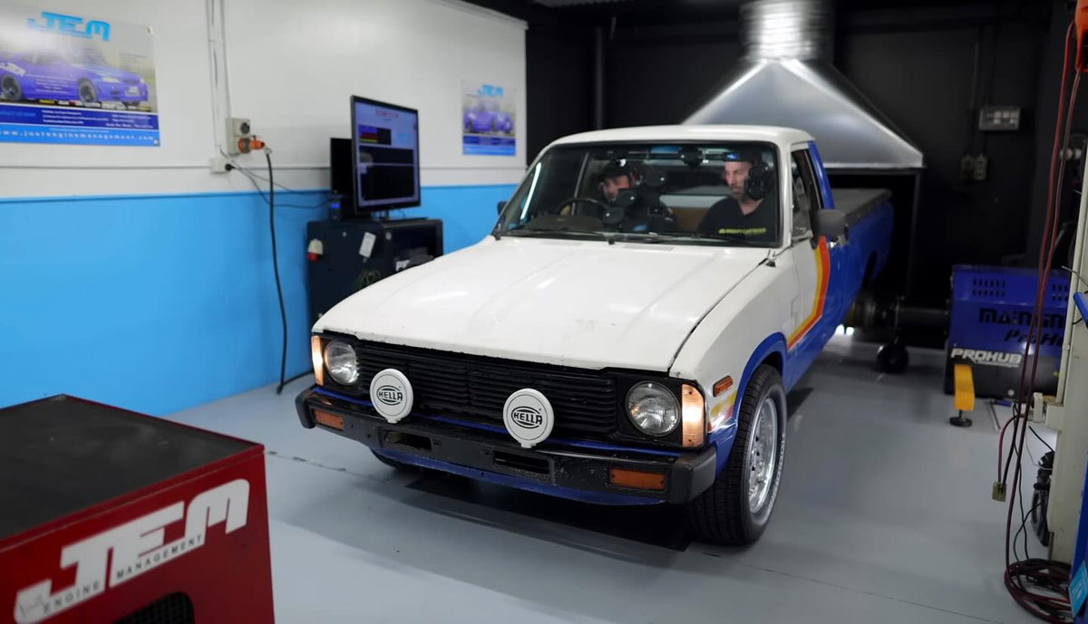

If you've been watching the build of our sleeper Hilux you'll have seen us throw the old single-cam carb-fed NA four-cylinder in the bin, in favour of a turbocharged 2.7-litre DOHC 2TR four-cylinder from a modern Toyota commercial vehicle. People have been impressed with the power this pretty simple engine has made (SEE THE VIDEO HERE) and this is partly due to how modern engines are designed.
