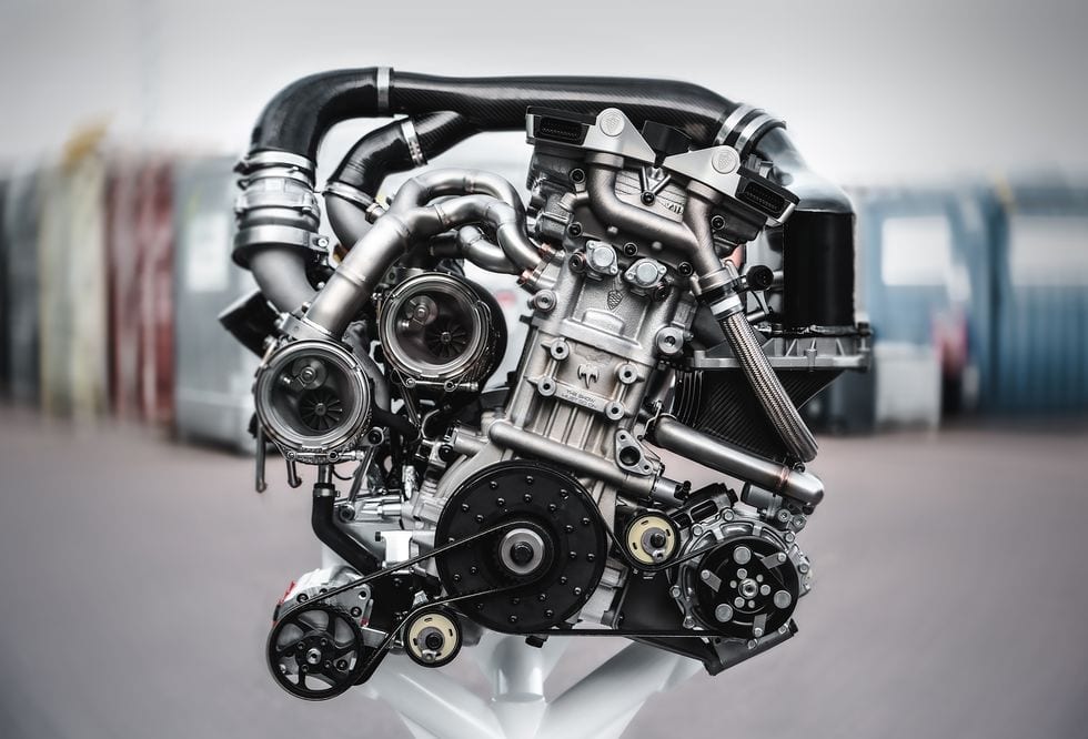

Koenigsegg's two-litre three-cylinder "Tiny Friendly Giant" Freevalve engine is rated at 600hp (447kW) making it the most powerful three-cylinder engine on the market. Unfortunately, while Koenigsegg announced the TFG was available as an option on their Gemera, low uptake for it led to them cancelling it in 2024.
