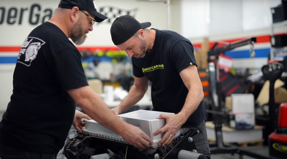

If you've seen the latest episode (CLICK HERE) MOOG and his best mate Al (and some hanger-on bloke called Marty) have started ripping into the Fairlady refresh, and the first big job they knocked over was to change the sump. We all know oil is the lifeblood of your engine (and if you don't, READ THIS) so it makes sense that you need to firstly keep a constant supply to your engine, and secondly hold all that precious liquid gold where it needs to be held.
The sump on MOOG's 240 was made by Al and the lads five years ago and it's been great, however it is quite tall. This has seen the precious pan hit the ground a couple of times, which is a very risky situation to find yourself in.
One big thump on that thin bit of tin and you can split it wide open, dumping all the oil and killing your engine in seconds. I've done this before, and was lucky to save the engine with lightning-fast skills... and truckloads of luck.
Part of any engine conversion is working out what sump options your swap needs, from custom sumps to off-the-shelf items from other models which use a similar engine. Whatever sump you choose also needs to work with your projected ride height and bonnet clearance, as you don't want the engine to be too tall for the chassis.
MOOG's RB-powered 240Z uses a Patrol sump and pick-up tube modified to fit in the low-slung sports car, which was all that was available when the car was built, but there are now better options around.

Factory sumps in 90s cars, like the modified Patrol sump used on the 240Z (shown above) often have to tread a fine line between cost and oil control. As Al explains in this week's video the purpose of the louvres in that sump is to act as a windage tray, which aims to prevent foaming and splashing of the oil by the spinning crankshaft.
Nissan wanted to keep as much oil as possible in the bottom of the pan, near the oil pump pick-up, and these windage trays are how manufacturers most commonly do this. You can buy aftermarket windage trays if you are trying to spin an engine much harder than factory, or have a lot of lateral G-forces you're working against (like high cornering loads).
Conversely, MOOG's aftermarket sump features a very thorough windage tray set-up, but also trap doors in the pan. High-performance aftermarket sumps often feature these doors to control oil slosh during high-speed cornering. They'll prevent oil from running away from the pick-up, which means your engine will enjoy stable oil pressure. Yay.
While aftermarket sumps can be expensive, getting a high-quality pan custom-made will make it painful to sit down enthusiastically for a few days. The amount of design and fabrication involved in high-quality sumps will have your head spinning, but then this is one of the most important parts of your car you're taking care of.
