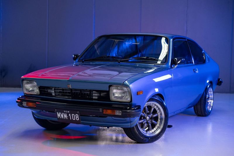

If you've seen THE EPIC GEMINI FINALE (CLICK HERE) Marty buttoned up a whole bunch of fiddly jobs to get the Gemini driving and engineered for road use, and a big one was finishing off his custom brakes. Now, because your ability to stop in an emergency rides on the brakes, any modifications to the braking system of your car needs special care.
