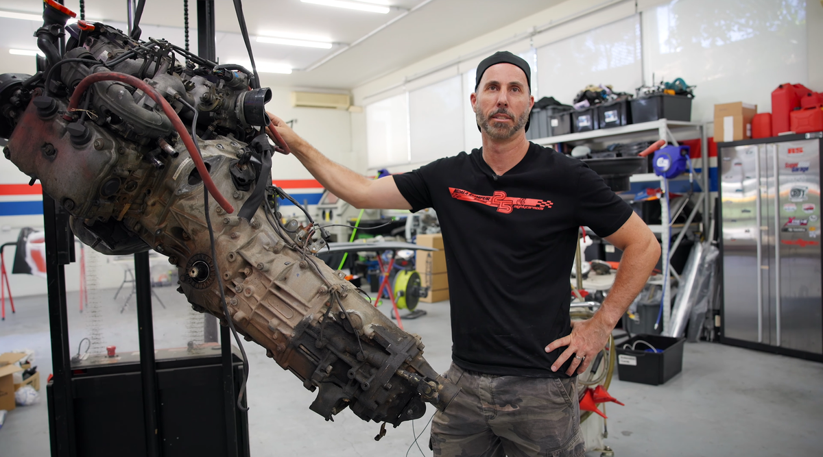

You can see below the seatbelt is enough for the fairly lightweight Subaru NA SOHC four-cylinder and small five-speed transmission. Seat belts have to hold humans in place during a crash, so they're rated to more than 1000kg, and can sometimes withstand jolts of up to 2500kg.
