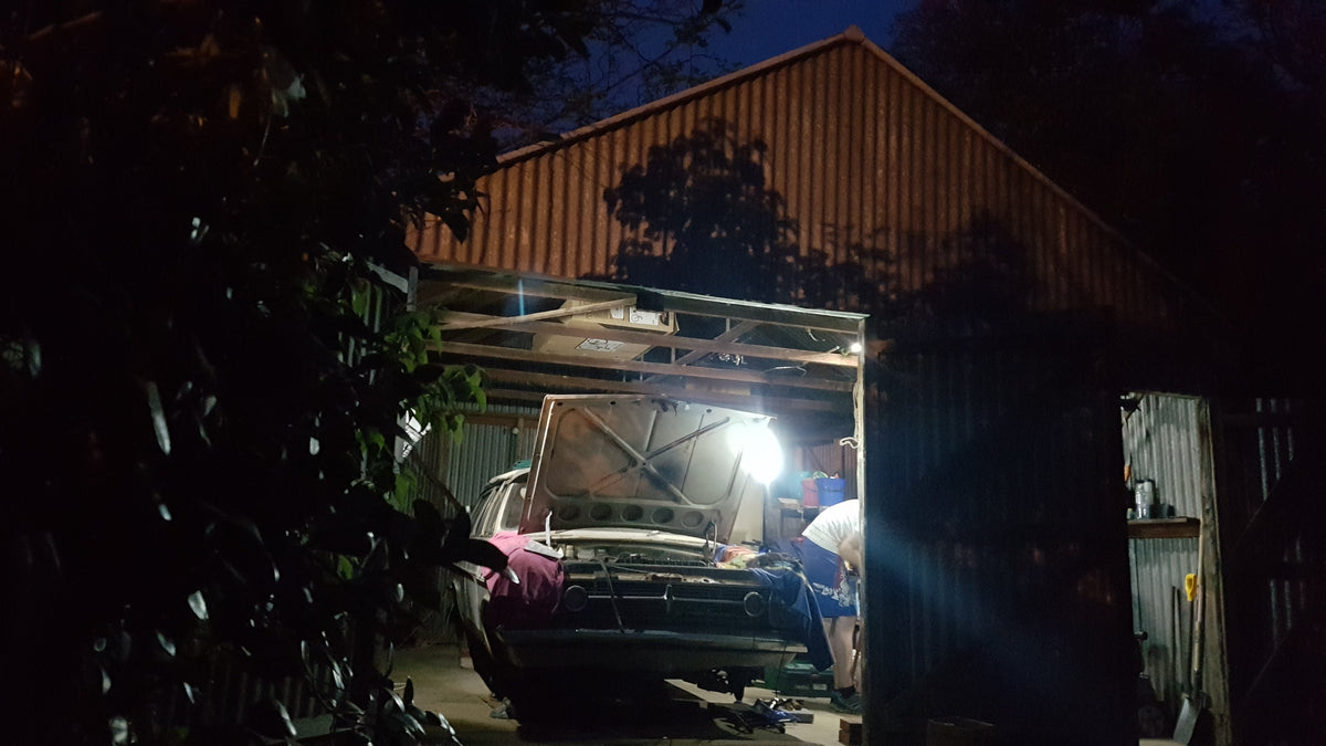

This is my good mate Drummo and the '67 Holden HR wagon he scored a bunch of years back. It had sat in a wrecking yard in Toukley on the NSW Central Coast for longer than it had been on the road.
When it came time for us to try to crank it into life a few years ago there was a bit of procedure to go through to ensure it wasn't going to chew itself to bits - we got it running (despite the lure of delicious adult cold snacks and BBQ meats) and so you can definitely get your nugget firing.
