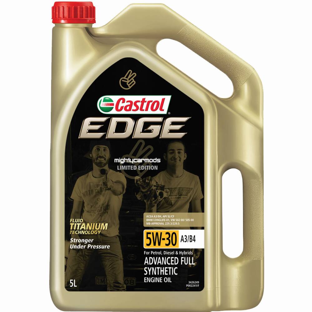

Synthetic oil is lab-developed to include additives to assist coating technology, improve viscosity, or add in detergents to help clean the engine internally, among many other potential addiitives. Modern high-performance engines run far tighter tolerances and perform under higher stress levels than old school engines, and this mandates the use of full synthetic oils.

The numbers on the bottles, like 5W-30, 20W-50, or 0W-60, relate to the viscosity of the oil, or the slipperiness of the liquid. The lower the number means the oil flows faster when the engine is cold, while the higher number relates to the oils viscosity at the engine's operating temperature.

Standard most LS engines run full synthetic 5W-30, but Troy Worsley from Warspeed Industriews who built by supercharged, forged 403ci stroker (below) recommends a specific mineral 10W-60 for high-compression, forced-induction LS engines... and this is different from the oil he recommends for the 2Js he's built, or his 10,000rpm 1500cc Toyota 5K.
