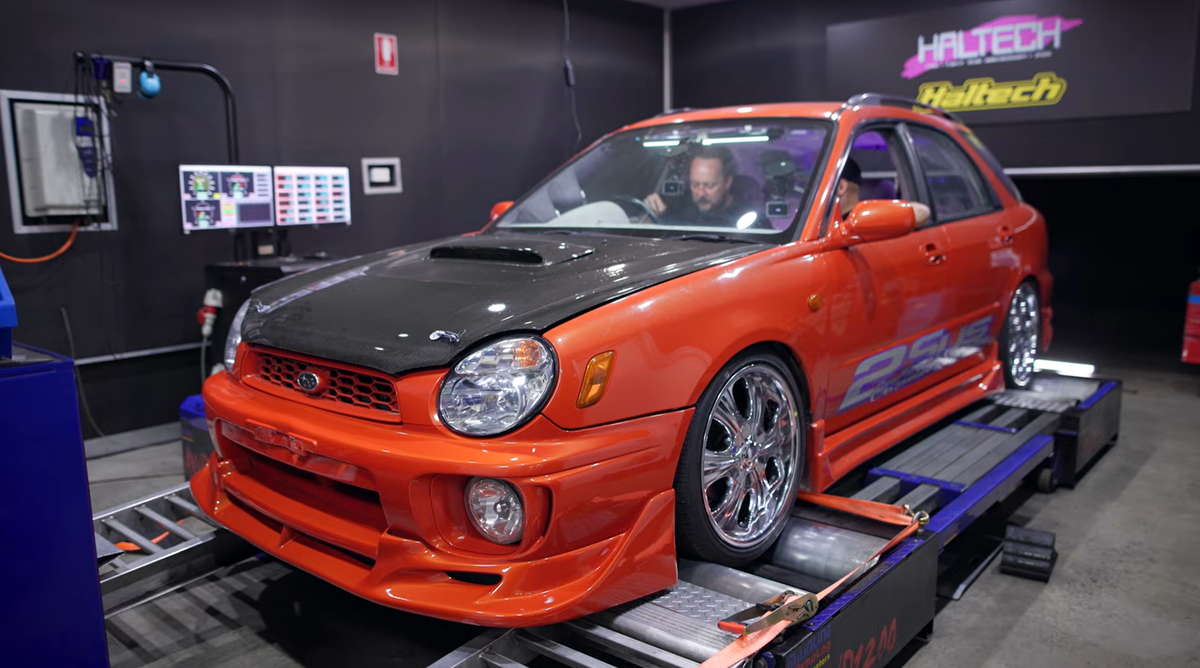

Le sigh. It's happened again. Our latest project car, the 4DMILF Subaru wagon, is finally turbocharged and ready to make the kind of power the styling suggested it had... then disaster. CLICK HERE to view the catastrophe.
If your only experience with Subarus is via memes, you'll probably think it's pushed a head gasket. However, the reality with turbo Subarus is the design of horizontally-opposed turbo engines means you're FAR more likely to spin a rod or main bearing. Which is only one step down the list of "Terrible Things You Don't Want Happening To Your Engine" from throwing a rod through the block.
