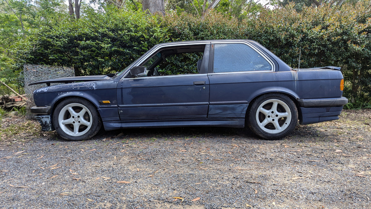

Rust is the one thing every car enthusiast hates dealing with. While it nearly always means you'll be going through the tedious process of painting and re-fitting a car, structural rust has the potential to kill a car outright.
If the actual structure to your car is compromised you really need to fix it for the safety of everyone in and around it. Similarly, catastrophic body rust needs to be fixed so your car doesn't fold up like a cheap deckchair if the worst was to happen.
While it isn't a simple job, you can save your beloved nugget with a lot of hard work and plenty of consumables. The scary part of this is knowing you'll see your car stripped back further than a bare shell - you'll need to de-skin your car!
