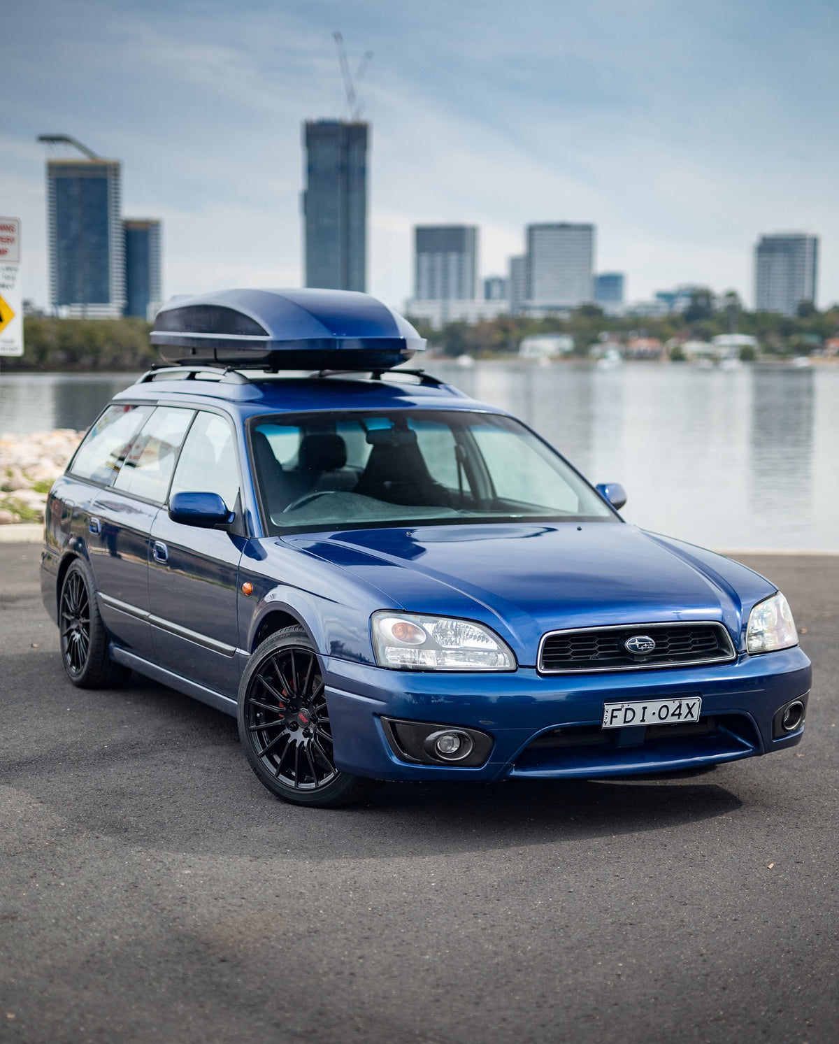

Subaru's "symmetrical AWD" system is possibly the most famous, so let's start off by looking at this layout, which uses a north-south engine layout like a rear-drive car. However, there are a lot of cleverly engineered details hidden in there which make for a reliable, compact, grip-filled drivetrain.
This diagram from THESE LEGENDS (CLICK HERE) shows how the Subaru transmission sends drive to the front wheels. The engine spins its power through the clutch and flywheel down a main shaft like a regular rear-drive gearbox, but the Subaru has a centre differential behind the normal gearset, which the spins a set of gears that pass the power back forwards to the front diff mounted in the front of the transmission.
In most regular manual Subarus that centre diff is a fluid viscous unit sending 50% forwards and 50% rear. STi gearboxes with the Driver Controlled Centre Diff (DCCD) technology have other modules installed to allow the driver to adjust the aggressiveness of the front and rear diff lock-up, but that is a whole other conversation for another day.
Subaru's AWD differs from others by splitting the drive 50:50 front:rear in most of their models, while other manufacturers adjusted for more front- or rear-drive bias to fine-tune the handling of their car. This treated the car more like a two-weheel-drive which could access more grip when needed, rather than a car with all wheels being offered the same amount of grip.
