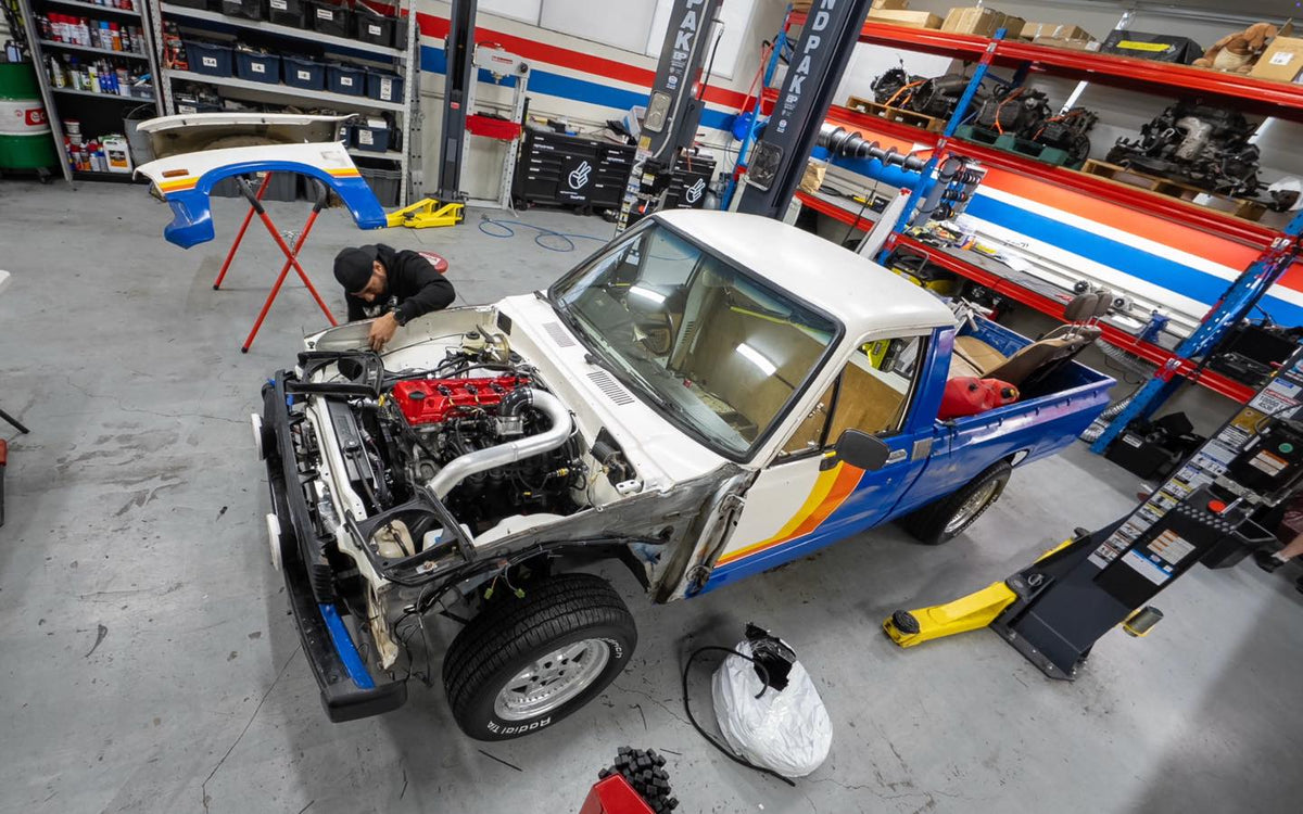

Find space however you can
When you pull a car apart you will find the parts will consume more than double the space. Giving yourself room to work is absolutely fundamental to being able to complete all the tasks you'll find you need to do to take a car from "meh" to "MAAAAAAAAD". When space is at a premium you'll have to be smart and strategic about how you tackle jobs, but I have seen people build amazing cars in single-car garages in apartment blocks - the key is to look around for how people work in confined space and use their ideas.
When space is at a premium, or you're working in borrowed space, you need to have a plan to tackle your jobs so you don't get in the way of other people. Hiring large workshop equipment to get jobs done (like swapping engines) without soaking up heaps of your precious space buying a large, bulky tool you'll only use once or twice. Being efficient with your space also means it is easier to find parts when it comes time to start putting the car back together, and you'll probably find these parts won't be damaged or broken from having been left in a pile you've tripped over a dozen times for a year or more.
Similarly, having tools or storage on wheels so you can empty your space out to work on your car is another great idea i've seen, while I currently use height and vertical storage options in my single-car apartment garage. You'll never regret having more space.
