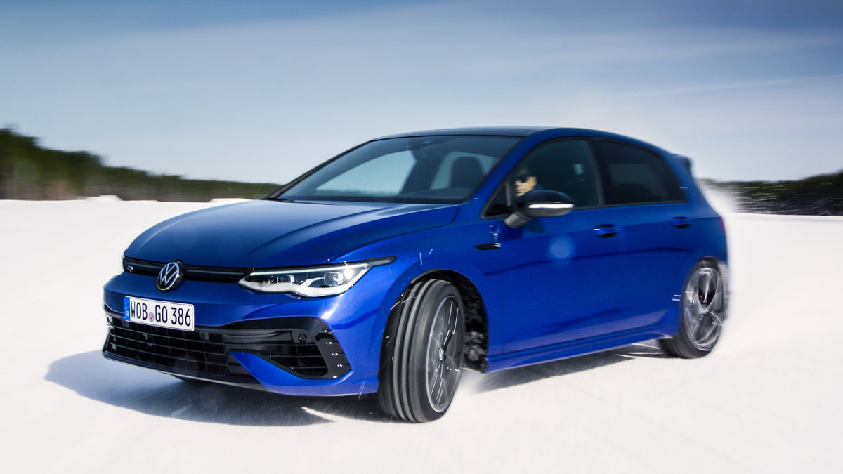

For the Mk8 Golf Volkswagen has moved on from Haldex-style electro-hydraulic tech. Known as Magna torque vectoring this electrically-operated system allows a greater amount of torque to be sent to the rear wheels and, crucially, for it to also be split side-to-side.
Haldex could only send up to 50% of the drive to the rear-end, and each rear wheel got 50% of that drive. But, in a hard-cornering situation the new-gen AWD can send more torque to the outside rear wheel, radically improving the Golf’s cornering abilities, limiting understeer, and allowing mad drifts.
While the Haldex unit sat in front of the rear differential, the Mk8 has clutch packs mounted on either side of the rear differential in front of the driveshafts. Worm gears driven by electric motors engage and disengage these clutches, splitting drive side-to-side but also allowing the rear drive unit to be completely disengaged for the car to drive completely as a FWD. This is unlike the Haldex system, which always ran a minimum of 5% or up to 10% of the drive to the rear-end.
Though both electric motors carry the same part number they operate in a slave-master type relationship, with the right-hand motor calculating the left-right torque split. Traditionally torque-vectoring technology has used computers to compile data from a mix of wheel speed sensors, throttle position sensors, and steering yaw sensors to calculate load on driven wheels, as this is faster-acting and more accurate than a mechanical or hydraulic coupling.
Interestingly because the electric motors can completely uncouple the clutch packs removing all drive to each rear wheel, the diff in the back of the Mk8 Golf R doesn’t actually feature spider gears. Also, the left and right-side clutch packs are designed to be serviced with different fluid from the centre “differential” unit in the middle.
