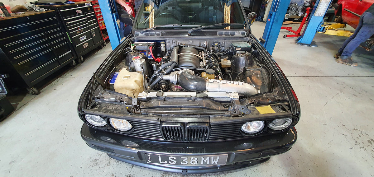

Since then I have had half a dozen friends cam their Gen IV LS engines in their daily drivers or primarily street-driven cars, and all have ended up with the #883 as the 228/238/113° specs give you a tough-sounding chop at idle with a fat mid-range that pulls hard from 4000rpm up to 6500rpm, and this was one of the big reasons Marty and MOOG chose this spec cam for their Black Chops LS3 E30 BMW.
In LAST WEEK'S EPISODE the lads brought Black Chops back to Brintech, partly to fix some rust they discovered under the brake booster when swapping the LS3 in, and while they had the engine on the bench they decided to throw some extra ponies in there to fatten up the mid-range. They hit up VCM Performance in Melbourne to get a full kit from them, which includes the cam, timing set, lifters and buckets, pushrods and more.
Thankfully because the lads chose to use a 6.2-litre LS3 Gen IV engine this means they didn't have to go through the process of deleting the dreaded "AFM" (Active Fuel Management) or "DOD" (Displacement On Demand) the Gen IV 6.0-litre V8s (L76 andL77, and the 6.2L L99) had for emissions purposes. The good news is VCM sell a full "DOD Delete" kit which provides all the parts required to get rid of this terrible tech, preventing your LS from eating a failing lifter... which often means a full engine rebuild.
