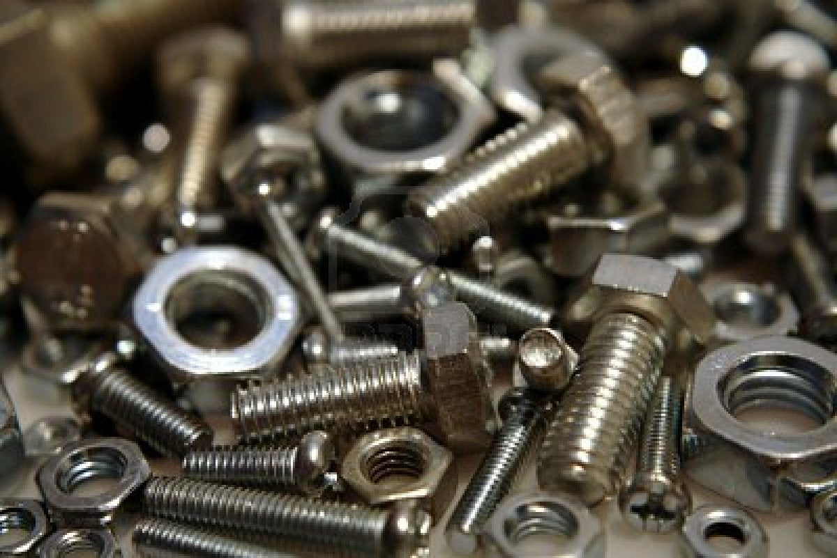

Fittings (bolts and nuts) are designed to have different size threads, and when trying to fit an incorrect bolt into the wrong threaded hole the mis-matched threads gall on each other and this is where the term "cross-threading" comes from. Sometimes, old bolts have been over-tightened, or get rusty and damaged, which stops the threads from cleanly meshing together as intended.

Next up, I'll run you through some of the different types of common fasteners used in cars.
