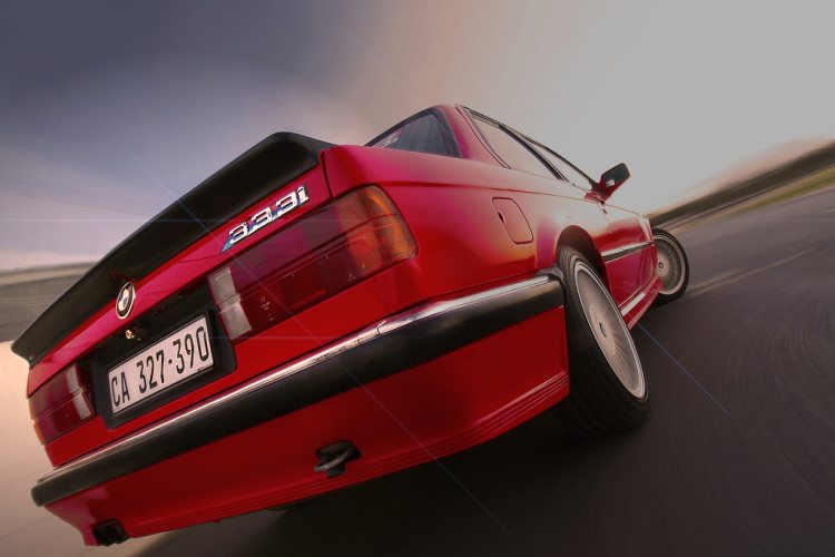

Because they - like Australia - missed out on getting the E30 M3, BMW South Africa came up with their own special model to homologate the E30 BMW for their local Group 1 racing regulations, all built at the local Rosslyn plant. From 1985-1987 they fitted 204 Series 1 E30s with the 3.2-litre M30 "big-six" engine from the 7-series to create the 333i.
The most powerful non-M-spec E30 at that time was the 323i, which came with between 138hp-150hp but the 333i boasted 197hp, although fitting the big six into the small 3 Series came with some penalties: buyers had to choose between power-assisted steering or air conditioning as there was limited space in the nose.
The cool factor didn't stop there, however. BMW South Africa knew the big six would fit because German tuner Alpina sold cars in Europe already converted. To make sure the South African model was up to the task of racing, the local BMW arm equipped the 333i with the Alpina-sourced brakes, intake manifold, gauges and wheels, while an MTech 1 bodykit adds more sporty flavour than what the garden variety 323i had.
