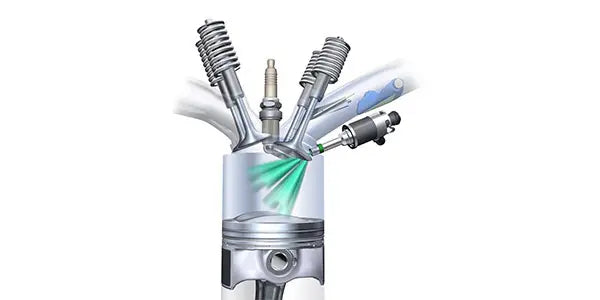

Direct injection (or DI) is where fuel is squirted directly into the combustion chamber at extremely high-pressures. This is done so manufacturers have far more control over each injection of fuel, and it happens at insanely fast rates. Basically, it is incredibly complex.
