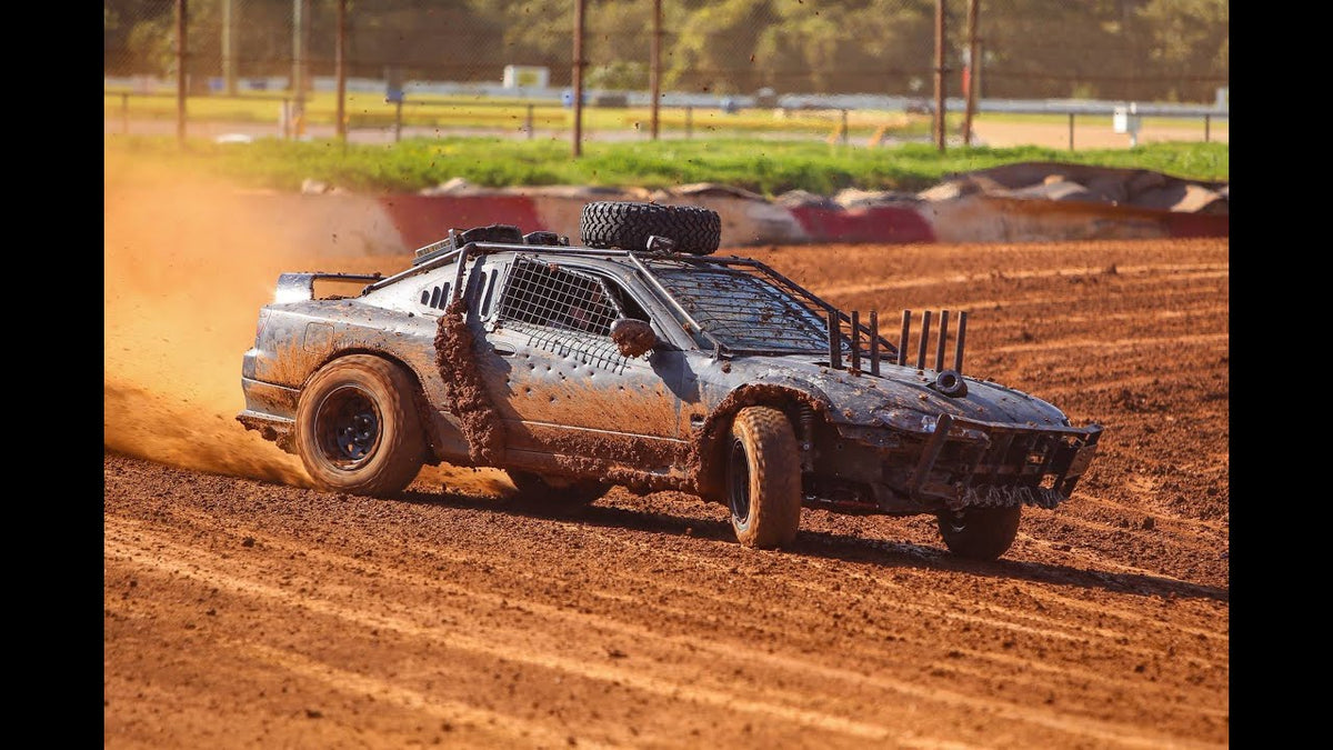

Mod Max, the Mad Max-inspired S15 200SX, is powered by a stock 5.7-litre LS1 from a Series II Holden VT SS Commodore. Originally rated at 220kW (295hp) it was treated to a set of zoomie headers, unlocked standard PCM (ECU) and a free-flowing pod filter intake but, apart from that, it remains a stock Canadian-built LS1.
For a 20-year-old engine designed to live a mundane life in a mid-range perforance sedan the engine has copped an amazing amount of abuse in its time between the Silvia's shock towers. It has run 12-second quarter-mile times on the mud tyres, been thrashed mercilessly at MCM events around the country (including being raced and pumping towering burnouts), and is then put back into storage until the next time it needs to be dragged out. Basically, we beat on it like it owes us money and it has never let us down.
