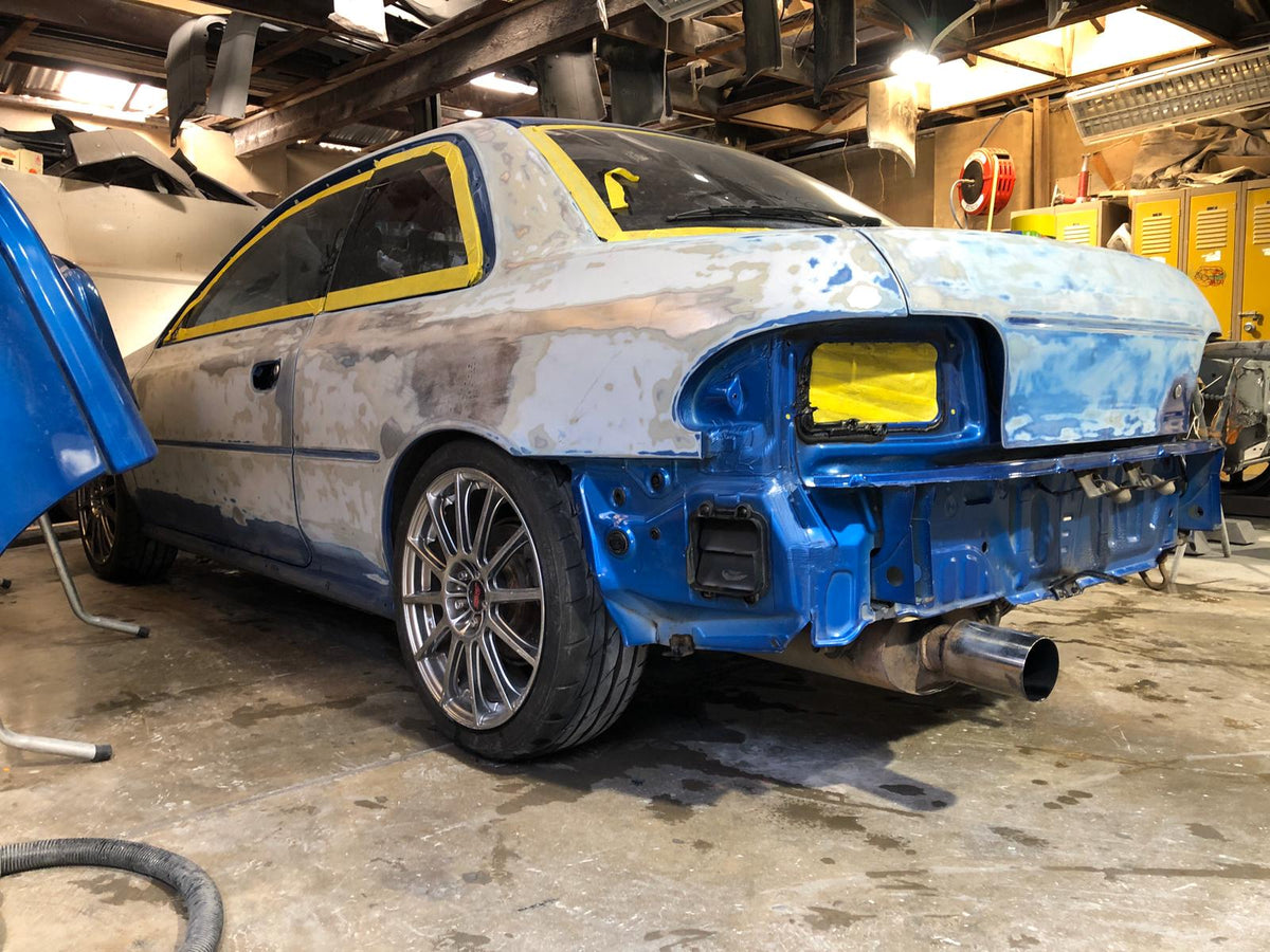

Getting a mad new coat of paint is one of the ultimate boogeymen to conquer when working on old nuggets, as getting a perfect shine on ruler-straight panels takes hundreds of hours of hard work to achieve. This is why it costs so much; you’re paying someone to devote weeks of their life to the job of fixing years of car park dings, rust, and old paint.
 Marty recently had his new 1999 WRX STi painted (as you can see HERE) as it had 20 years worth of dings and scratches on it, but even though it wasn't a crusty, rusty old nugget (like a certain Mira they cut in half in Japan) it still needed plenty of work to make it mad.
Basically, if the car's panels aren't straight and properly aligned, then your shiny paint job will look uglier than a drop-kicked kebab.
 Any paint job needs the right surface texture to bond to, as paint requires a chemical adhesion to the lower layers. Rust, grease and other impurities hiding under the new paint will cause it to have poor adhesion, which is a fancy way of saying the paint won’t stick properly. Think of it like trying to paint a sand pit by painting over rust or old, flaky paint and clear coat.
Modern plastic body fillers (also known as ‘bondo’, ‘bog’, ‘mud’, and in some cases ‘the talent-replacer instead of doing proper panel beating’) provide even better adhesion and pliability.
Once the bodywork is repaired and sealed it needs to be sanded through a range of different grits of sandpaper. The lower the number, the harsher the grain of the paper, so most shops will start at 80-grit, stepping up to 240, then 400, 600 and sometimes, even 800-grit, before the car is ready to be painted.
Depending on the paint you've chosen, your bill for materials can be huge or unbelieveable. A clear-over-base, pearl or metallic-finish paint costs more than a simple solid colour, let alone a multi-stage paint like a candy which sometimes requires four-times as much time to paint properly.
There are also costs involved with preparing the car for each of these stages, but also costs to keep a paint and panel shop open. From the power bill to the product needed to clean spray equipment, sandpaper, masking tape and plastic, and even respirator filters, there are many overheads to pay before you get to buying primers, or top- and clear-coats.
