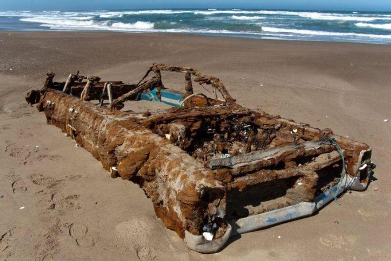

Rust is the single biggest killer of cars, and it is not always easy to see. This is why you should always inspect potential projects thoroughly. And in the daylight. Or at all (hi MOOG).
This rust in my car looks terrifying, but it was actually easily repaired by a shop. The most difficult part of some rust repairs is forming compound curves (where the panel curves in multiple different ways), however I was lucky this rot didn't get into the structure of the car underneath because that would make the repair massively more difficult as you'd have to cut back huge parts of the car to fix it (otherwise known as "de-skinning" as you take the entire panel skin off).
