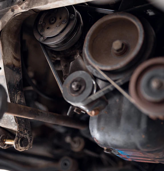

One area many project cars stumble over is electrical gremlins related to the charge system. Sometimes this can be from a non-functioning alternator or from poor alternator wiring.
If you can get the car running, turn some electrical systems on (like headlights, stereo, and even windscreen wipers or the A/C). Measure the voltage at the battery terminals, then between the battery ground and the alternator terminal. If you see more than a 0.5-volt difference your charge wire and ground wire aren't up to the job - you should also run a ground wire from the alternator of equal gauge!
