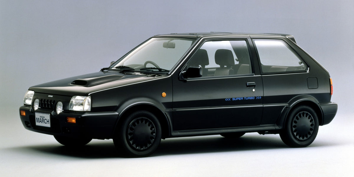

But, when they did start working they hit you with all their power at once and early turbo cars were known for being nearly impossible to control such was the rush of power a turbo gave. On the other hand, superchargers worked great down low in the RPM range, but ran out of puff up top... kind-of like Marty running up a hill to get the last tofu kebab before Moog does. That honk we all know and love from Marty’s mad March Super-Turbo (check it out HERE) is the sound of a supercharger squishing atmosphere as best it can.
The theory behind twin-charging was that a supercharger would operate down low to give good low-and mid-range power, before a turbo came in up top once the supercharger was out of its efficiency range and you’d get a mad top-end full of tsu-tsu action.
The issue was the system is incredibly complex, especially when controlled by an old, out-dated 1980s ECU – Marty still has nightmares of vacuum hose-spaghetti. As turbocharger and EFI technology radically improved through the 1990s the complex twin-charged systems fell by the wayside as manufacturers were able to build more responsive, better-performing and more-reliable engine packages for their cars.
Nissan’s March Super-Turbo was the first real, commercially available twin-charged car and while some others played with the theory it stood for many years as the only successful twin-charged production car until the Volkswagen-Audi Group introduced the 1.4TSI in the Mark V-era Golf.
