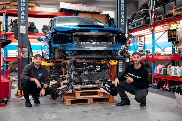

Tackling a drivetrain swap is a huge, complex task even when all the parts bolt in like Lego. When you set out to do a drivetrain swap one of the best ideas you can have is to grab a complete donor car and park it next to (or near) your project.
This will give you important visual clues to what parts you may need, or modifications you will need to do to make your dreams roar to life when you twist the key for the first time. With a running and driving donor car you’ll have all the pieces you need to make your car work, and you can see how it all goes together.
Buying a donor car will also take some of the risk out of compiling a complete swap piece-by-piece, as you can be assured all the parts work together and nobody got you by selling a 4.5-speed FWD gearbox as the similar RWD 6-speed unit. This can be a risk as people might advertise the parts mistakenly – there is no mistake when you can see and drive the donor vehicle, though!
You can also double-check part numbers for replacement parts you need to order off the ones you yourself pulled out of the donor. You're giving yourself a safety net!
Buying a donor car is sometimes about being in the right place at the right time. Finding a VA STI with just enough damage to write it off, but not so much it destroyed the car took a little time and patient waiting… before MOOG jumped on the seller of the blue VA and paid over the phone.
It’s rare you’ll be able to take time to make the purchase of a good donor car like this STI as a lot of other people will be after it for the cool upgrade parts it has. Sometimes it can be worthwhile talking to wreckers to let them know you want a complete car for a project, and if one comes in get them to give you a buzz to organise buying the whole thing.
