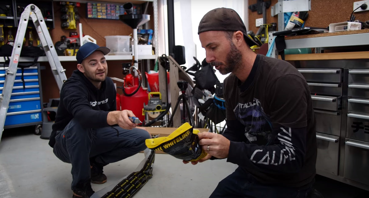

We often see people go into a new project thinking they'd just lower it, before Scope Creep means they're adding all-new coilovers, mad wheels and tyres, big brakes, and all sorts of other mods. But is this the smart way to modify a car? In the latest video on Marty's STi (check it out HERE) and MOOG's BRZ (check it out and get your nose disrespected HERE)  the lads answer this question by looking at some oft-forgotten parts of a car's suspension system: swaybars!
