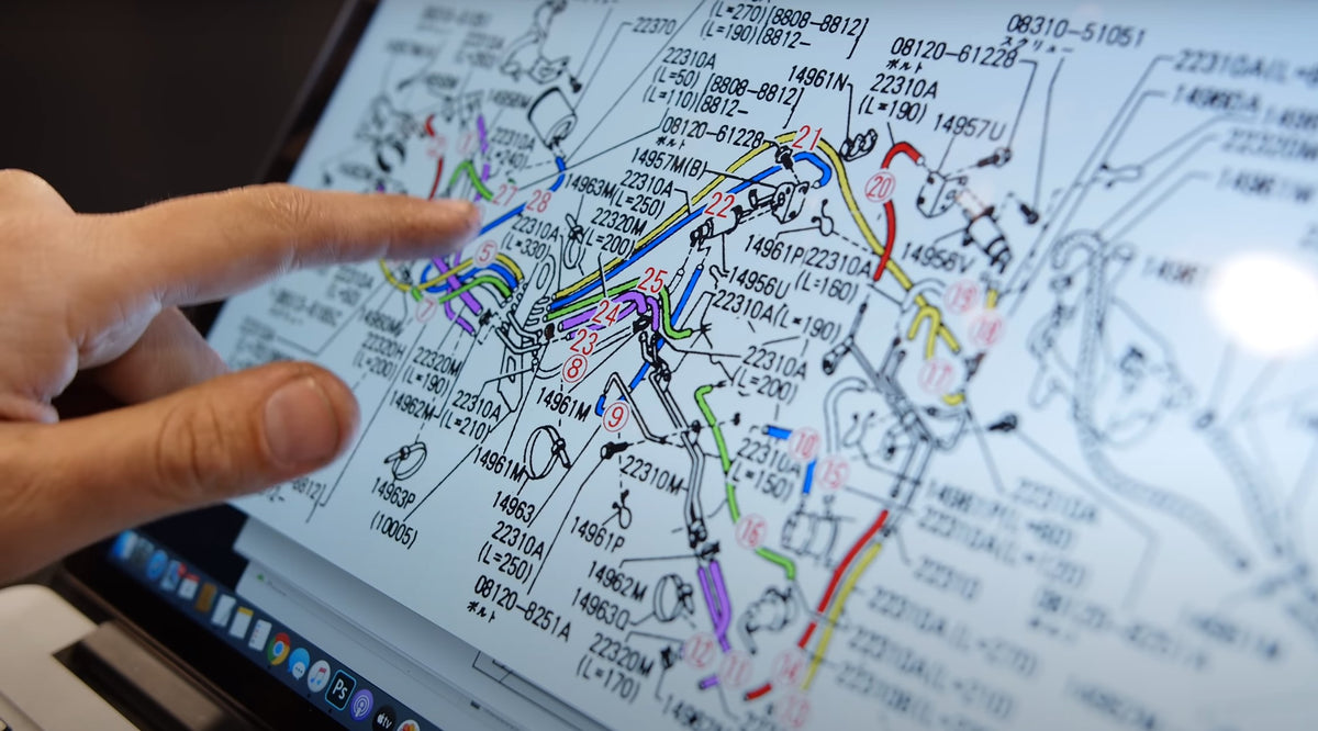

Triple-checking your diagrams are correct (or are for the correct model they claim to be) could have saved me about 3 full days when trying to discover why my car didn't start. As it turned out the file I'd saved was incorrectly labelled and was for a different model whose ignition switch was wired a different way.
