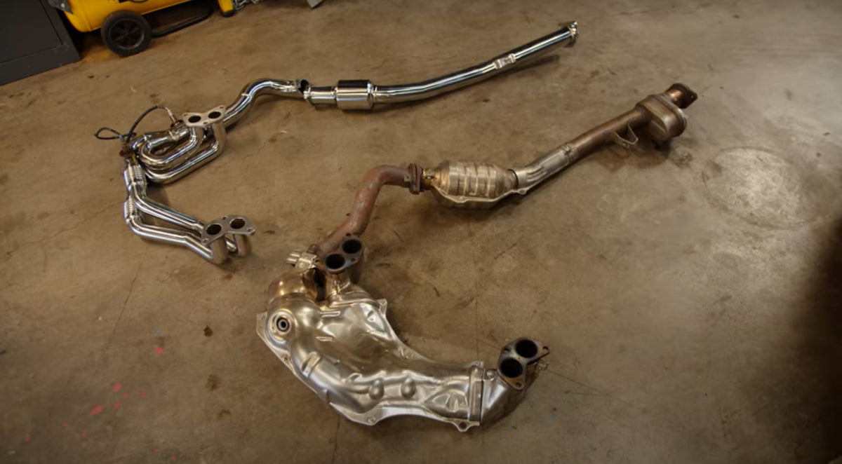

We find it is a good idea to lay your old and new systems on the ground beside each other to make sure you have all the bits you need, and they look vaugely similar. When it comes time to install all the New Hotness don't bolt everything up tight straight away - leave the joints loose to give you extra wiggle room so you can get everything mounted to the car, then tighten it all up once it is in place and you don't need any room to fenergle the doohickeys.
