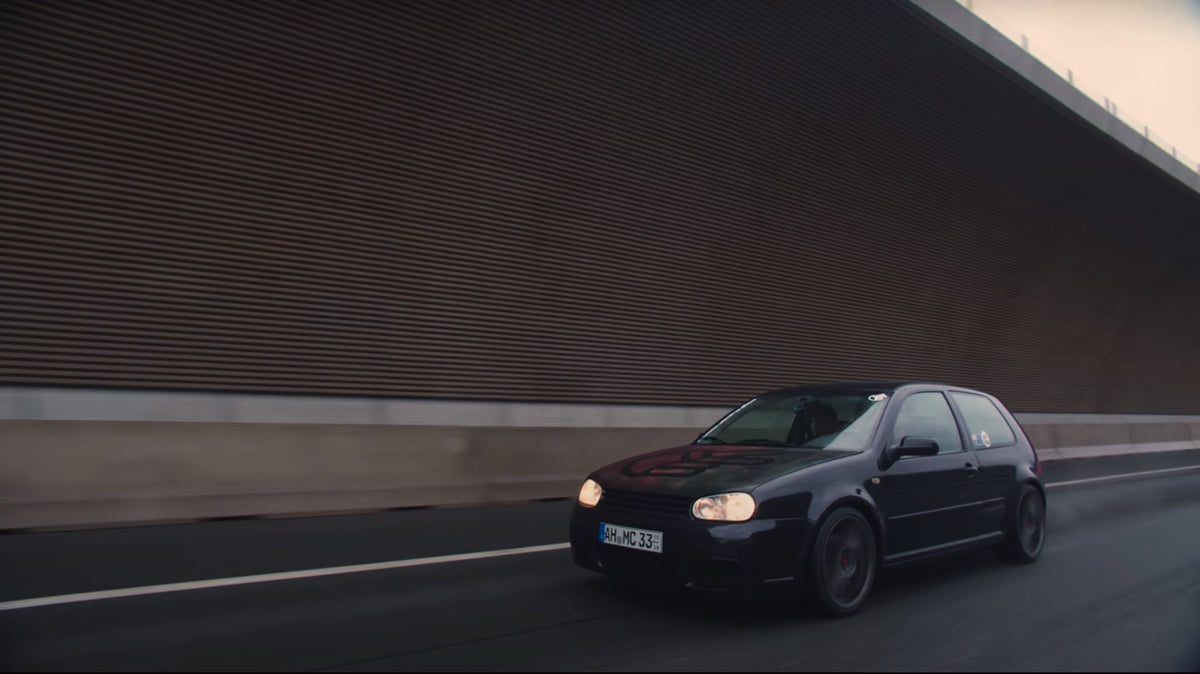

When we did our TURBOS & TÜV movie (check the video HERE) our mate Björn helped us buy the cheapest VW Golf GTI on the Internet and was instrumental in guiding us through the legalities of modifying a car in Germany. He has just re-registered the Golf in Germany and gave us a great rundown on the process. This is Björn in the back seat. Say g'day to everybody!

Now Björn can get back on those awesome German roads...
