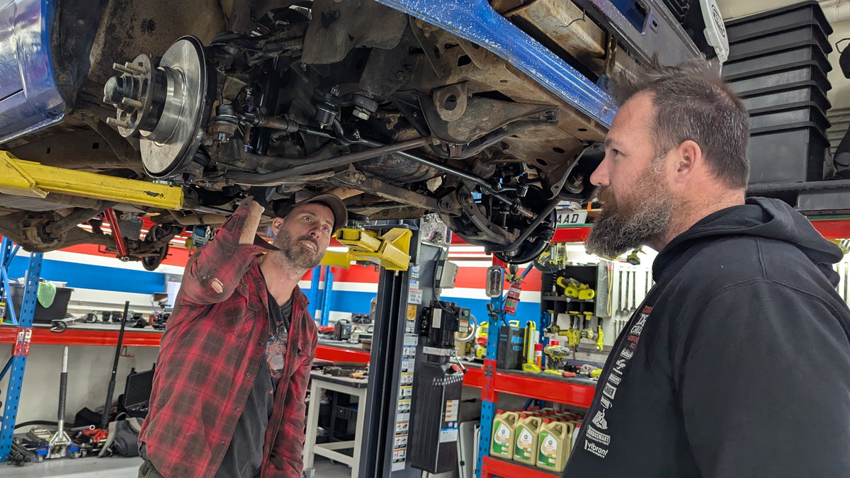

WORK WITH FRIENDS
Having a friend on hand to assist you is a key to working on old cars. Sometimes you can tap them in when you've used up all your brain or arm muscle, but they can also offer alternative insights into how something may come apart or go back together.
Mostly, it's important to have someone to rage with about the stitch-ups you encounter, or to sympathise when you smash your knuckles into cold steel undoing a stupid bolt. Frustration shared is frustration halved.
