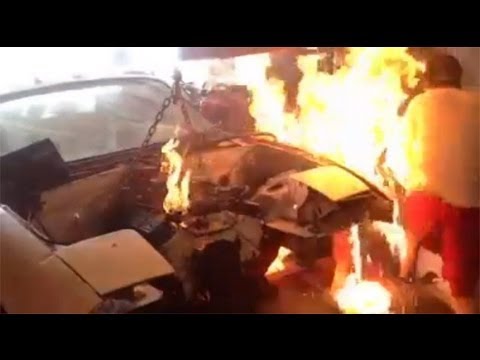

Most workshops would also choose to disable the fuel injectors for the first cranking attempt, so you can also check for fuel leaks without risking burning your shed to the ground.
