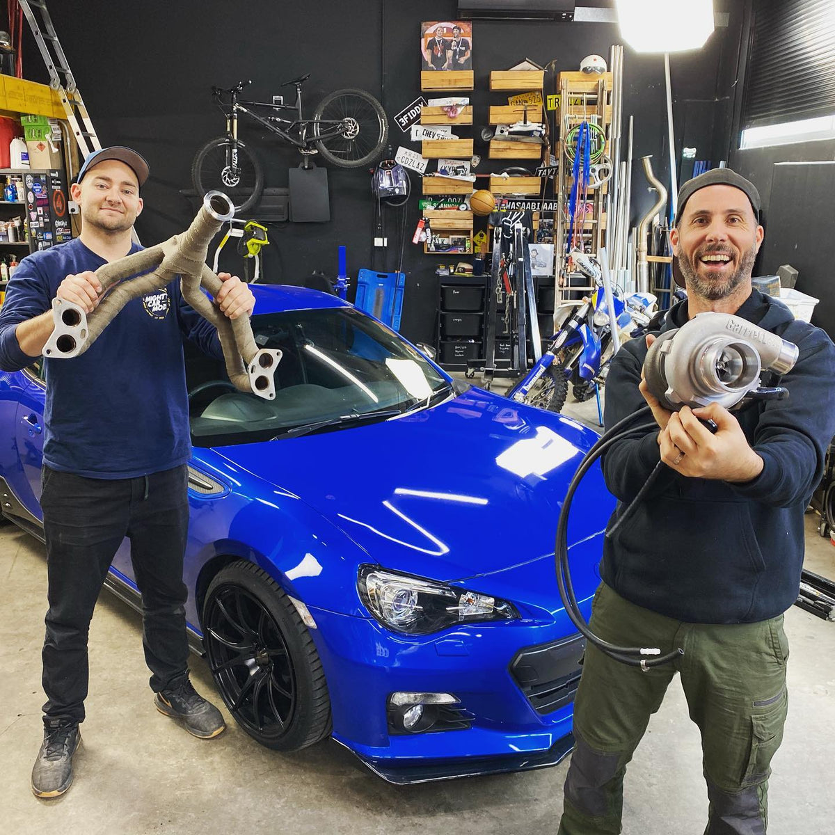

Firstly, if you have a popular car, like MOOG's former BRZ, you can potentially pick up a sick turbo kit that makes everything easy - as he found out in THIS VIDEO. However, what happens when you don't have a car that has a kit available, or you want to do something individual?

For the air side of things you need a way to get the air into, and out of, your engine via the turbocharger. This means you need to sort out a pre-turbo air intake, an intercooling system up to the throttle body, plus an exhaust system, and a way of mounting the turbo to the cylinder head to scavenge the spent engine gases.
Sometimes you can be lucky and find an off-the-shelf exhaust manifold, but sometimes you'll have to make one, or have it made. Basic combos can use the tried-and-true, simple log manifolds, while spicy set-ups might work best with tube spaghetti manifolds - it all depends on the engine you're turbocharging, and how hard you'll be pushing it.
Don't get too hung up on the material used in your manifolds and piping, but remember steam pipe and thick-wall steel will deal with heat and road driving vibrations much better than thin-wall tube.
