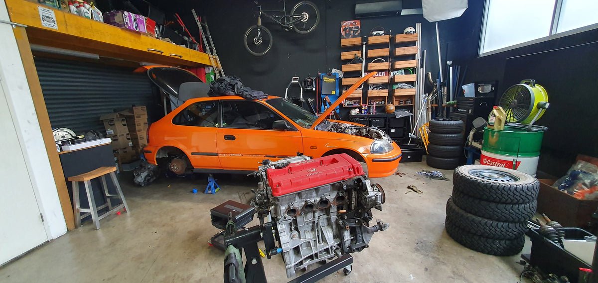

VTEC, otherwise known as Variable valve Timing and lift Electronical Control, has become a byword for Honda high-performance shenanigans since its introduction in 1989. But how does it add the magical horsepower to tiny naturally aspirated petrol engines (LIKE THIS ONE IN THE NEW EPISODE HERE)?
