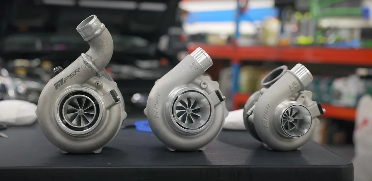

There are many ways to push more air into an engine, and they're all loosely referred to as "super-charging" as this intake air is known as "charge-air". Boost-adders come in many forms: belt-driven superchargers (known, traditionally, as superchargers), exhaust gas-driven superchargers (called turbochargers), chemical supercharging (nitrous), or "passive supercharging" where air pressure from the bellhousing or cowl area is fed into the engine.
All these different methods have positives and drawbacks depending on packaging, efficiency, weight, and more. One of the biggest considerations for choosing a method to ram boost into your engine is how much heat it will introduce, and how effectively you will be able to get rid of that heat.
