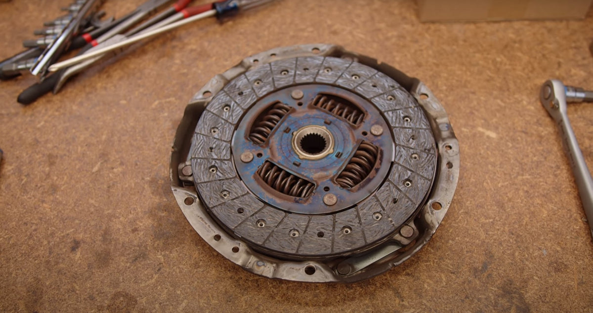

In the above photo you can see the friction disc sitting inside the pressure plate. You'll also see four small coil springs. These springs help cushion vibrations and give you buttery smooth engagement as you let off the clutch pedal.
Some friction material discs are made in "puck" styles, which are a star, four- or three-pointed shape. These can have very aggressive engagement, so some clutch manufacturers make products with multiple friction discs. This is where you see "twin plate" or "triple plate" clutches (like what Marty fitted to his STi HERE), which have special pressure plates and friction discs to clamp massive horsepower loads but still give smooth engagement.
