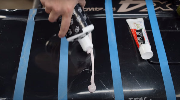

You'll need to pick up a special type of polish to buff your car's paint, which is called cutting compound. Watch the latest episode HERE where the boys give you a rundown of different levels of cutting compound, from super-cheap to the type used by professional detailers.
These are also sold in different stages of aggressiveness, from a mild cut to heavy for really damaged paint that needs to be harshly cut back to reveal fresh paint underneath. If this sounds pretty hardcore, that's because it is and you can easily damage your paint beyond repair if you just go for the hottest sauce you can get. Don't be afraid to start with a mild cutting compound!
 Once you've sauced up the panel with the polish, spread it around wth your buffing pad before turning the machine on. (Marty got excited and used a little more than necessary) You don't need to press heavily onto the surface, just let the machine glide across the top of the paint as the spinning motion will create heat in the metal and this can burn the paint off if you go too heavy-handed.

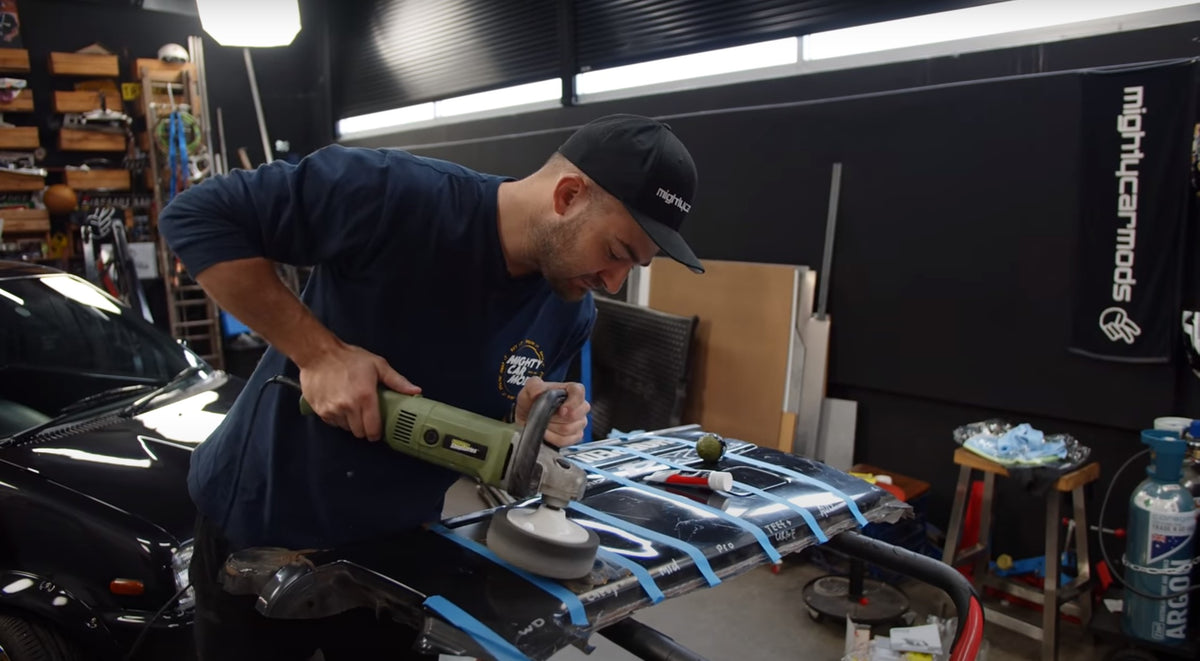

Once you have spread the compound, it is time to get the spinning sheep onto the case with a buffing pad. If you're used to polishing a car by hand the process of machine-buffing will blow your wormhole - it makes an all-day job take several minutes.
MOOG used a new Ryobi buffer once he had blown the buffing pad off with some compressed air just to ensure it is clean. Again, don't press this down hard onto the panel's surface, just let it glide and the spinning motion will bring out that fine shine.
