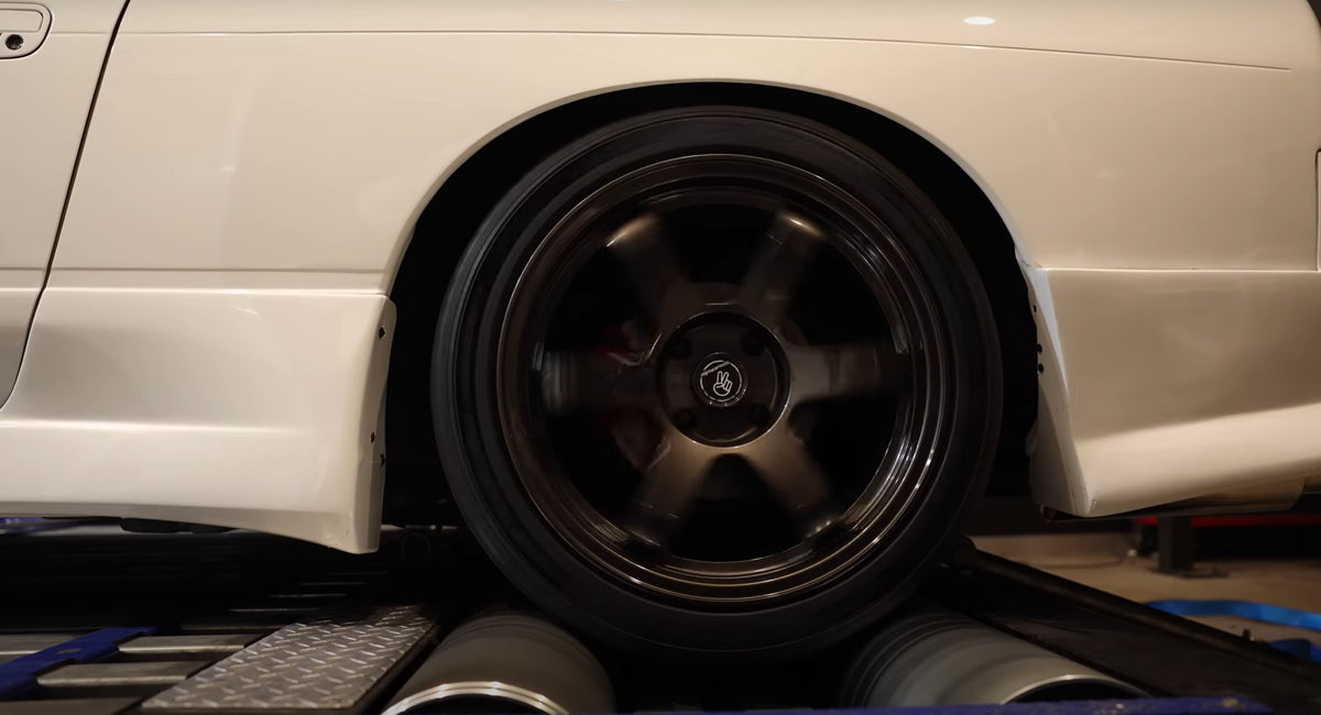

 If you've seen the latest episode, where the 180SX hits the Haltech dyno (CLICK HERE) then you will have heard Tuning Fork talk about why peak power isn't as important as having a good amount of llamathrusts "under the curve". We don't want to harsh anyone's vibe, so here is your MAHOOSIVE SPOILER ALERT!!11onejuan
