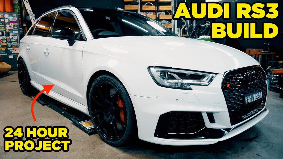

In the latest episode (see it HERE) of Mighty Car Mods we see MOOG's VW RS3 run on the dyno and some people will be wondering if a stock RS3 is rated by Audi at 394hp (294kW), why did MOOG's car make LESS than that after all those mad Revo mods? Actually, kids, it didn't.
*SPOILER ALERT* DON'T READ ANY FURTHER ON IF YOU HAVEN'T WATCHED THE VIDEO AND WANT TO KNOW HOW MUCH POWER MOOG MADE
When manufacturers display how much power a car produces, they are claiming this as measured at the crankshaft, not at the wheels or hubs like most aftermarket tuners do. The other fact which can be confusing is the difference in measuring power, between kilowatts and horsepower, as one measurement is metric and one is imperial. I'll get to those differences later, but let's look at why cars make less power "at the wheels" compared to their rated power at the engine...
A car's drivetrain (transmission, differentials, etc) all chew up little bits of power through what is known as parasitic loss because it takes little bites of energy to get all the parts of a drivetrain (transmission, tailshaft, driveshaft, wheels and tyres) spinning to put the engine's power to the ground. Back in the old days it used to be thought that as much as 25% of a car's power would be "lost" by the time it got to the wheels, though modern cars seem to be much more efficient.
This relationship is not always linear, as a 1000hp car isn't necessarily going to lose 250hp through it's drivetrain, just like a 100hp car may not lose 25hp. But, you get the idea: gearboxes and diffs other rotating parts all change up the numbers
So, a brand new RS3 will have 294kW (394hp) as measured at the engine but most will only produce around 230kW (308hp) at the wheels, indicating a parasitic loss of 64kW (86hp) through the stock drivetrain. MOOG's RS3 made 290kW (388hp), approximately 60kW (80hp) more than what a stock RS3 should make at the wheels. If we estimate his car also lost 64kW (86hp) through the drivetrain then his engine should produce 353kW (474hp).
