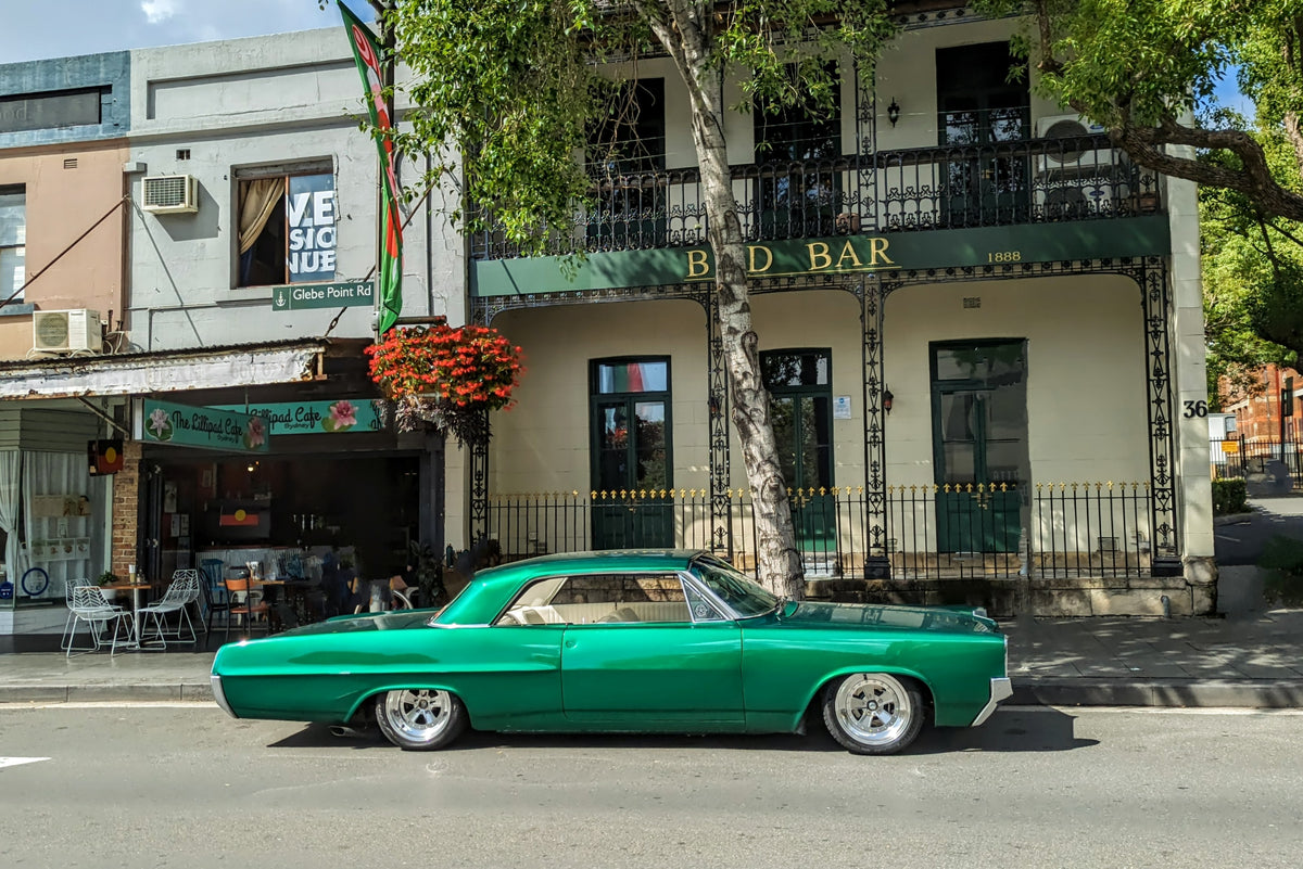

Here is how I set up the A/C in my 1964 Pontiac Bonneville (which you may have seen HERE).

The shape of my Pontiac's crossmember and the extra idlers needed for the supercharger belt meant I couldn't fit an air conditioning compressor on the engine. Having A/C in my classic car is a must for me, as I want to drive my car year-round and do so in comfort. This meant i had to look to other options, and I soon found THIS REMOTE-MOUNT compressor
