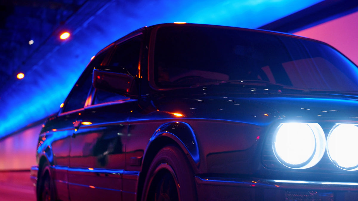

MCM's first ever E30 BMW has been a crazy trip in just one short week, building a mild-looking sleeper packing a 320kW (430hp) punch in a fairly light, dynamic rear-drive package. You can check out the brand new reveal video HERE, but let's run you through the whole mad week's worth of this killer project.

Smashing job lads! I’d love to see the cover as a wallpaper, the colours are supper mad and this would be going straight onto every screen I can put a wallpaper on!
