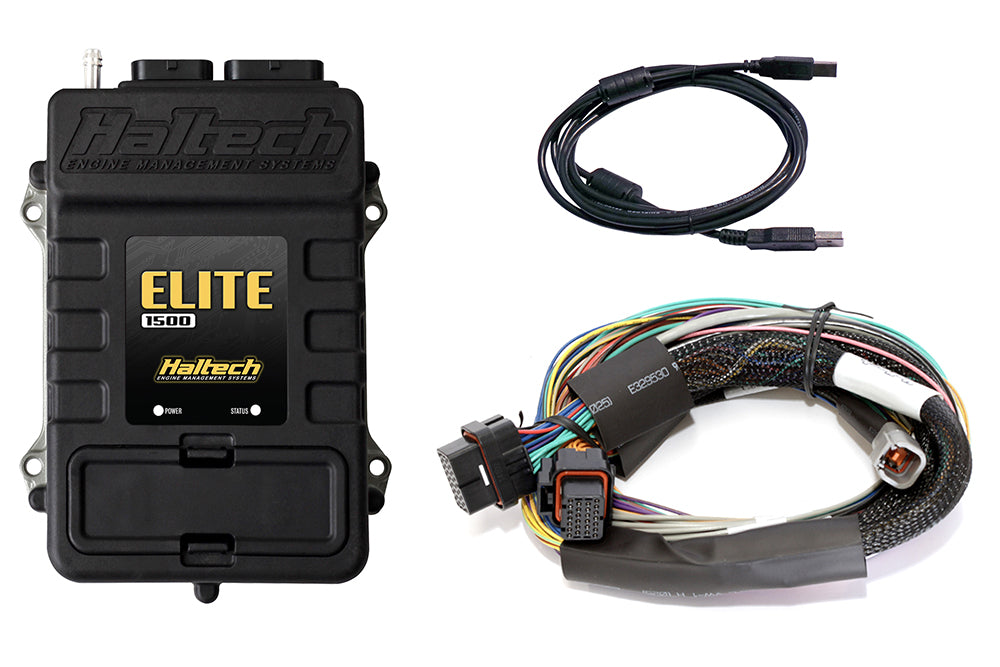

01. ECU
We chose a Haltech Elite 1500 as it allows Drive By Wire (electronic throttle) control along with a myriad of other features. We used a basic harness kit along with a few extras found below.
