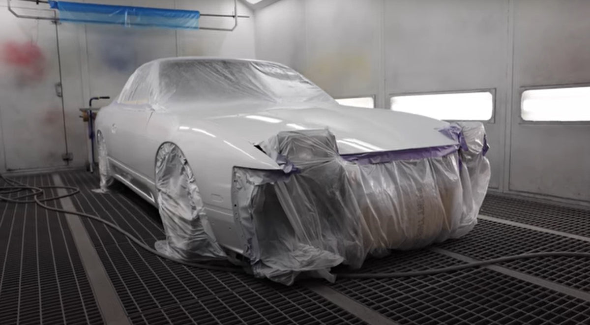

Seeing your project car gleaming with brand new, fresh paint is one of the best times in our car enthusiast life. MOOG knows this all too well with the crisp white paint now resplendent on his 180SX project, as you can see in THIS EPISODE.
Getting the car painted is just the start of a new phase of the project, as we then have to put the car back together. It is an exciting time and it is important to take a little bit of a breather to calm down as you can reassembling the car and end up having a disaster or making more work for yourself.
