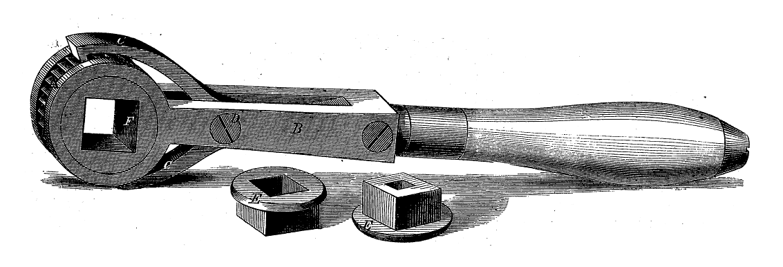

RACHETING BREAKER BAR
Are you regularly changing wheels? Needing to turn your engine over by hand or undo a bulk lot of very old, very rusty bolts that you don't want to snap by using an impact gun? Get thee a racheting breaker bar. I spent a bit on a quality brand because I'm habitually pulling wheels on my cars to check wheel bearings, brakes, and the like.
